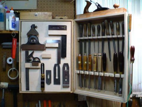

Great stuff Todd!....love to see a well organized collection of beautiful tools. (Since each plane has a specific spot, did you relieve a pocket underneath for the protruding blade?)

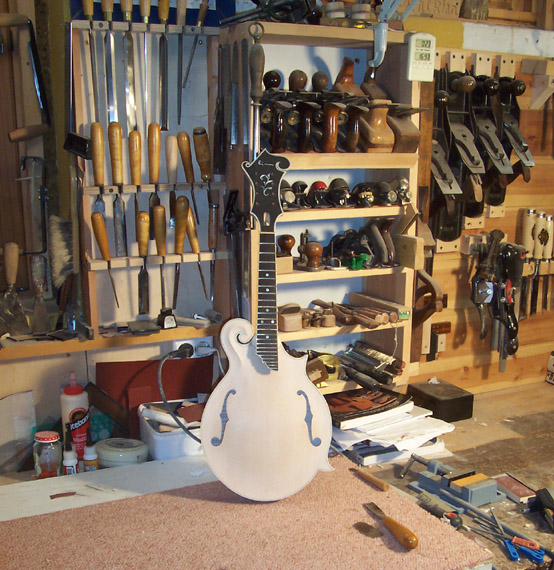

I built a limited form of the above from a drawer that was a little off square from a kitchen cabinet I made.  I just made a second one with the same dimensions for the outer door, and put a flap on the inside.  The Chisel rack is removable, and can sit on the bench, though I don't find myself doing that.  The planes sit on thin cork with a gap where the blade goes.  Wide gap so I don't have to look too closely when putting them up.  It works great, but is not big enough.

Here's how I do it. I put a thin piece of wood on the edge of two of the shelf where the planes rest so the sole of the plane only touches the shelf at the toe and the thin piece of wood at the heel, thereby suspending the middle part off the shelf to protect the cutting edge.
Longer planes are stored vertically, but tip away enough from the wall so the irons never touch the wall.
Violin planes are stored in a separate box so they don't disappear among the clutter. Router planes, plow planes and so on are just stored vertically on a flat shelf. I now also have some more fancy infills and specialty planes in that shelf...
I like the open, easy access of this system, and I have not had any accidents with dropped planes etc. since I put this together about 7 years ago.

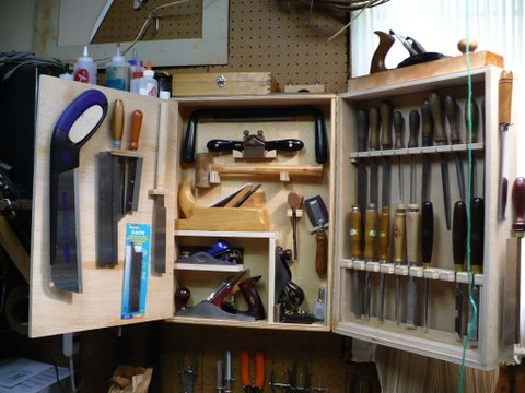

On the wall behind me (bench is freestanding) This is supposed to have a double layer of doors like Waddy's smaller one, but I haven't gotten around to it yet - it detracts from instrument building time! (It needs a few
hangers for spokeshaves on the back of the main case above the top shelf, too.)
